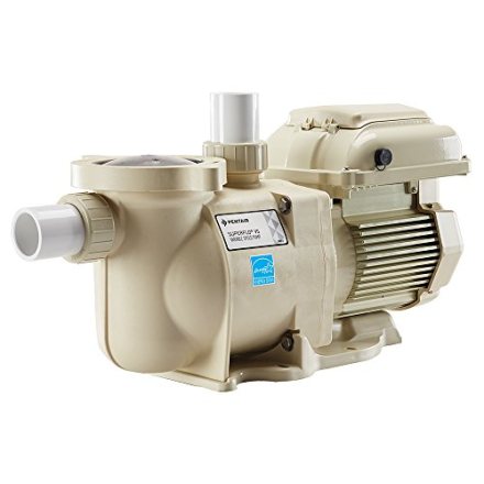

Apparently my pool guy wants $800 to install a variable speed pump that he claims runs 24/7, but I'm skeptical about whether that's really necessary. I'm particularly interested in understanding how they balance filtration requirements with energy efficiency, and whether the speed modulation eliminates the need for complete shutdown periods during normal operation.
Variable speed pumps can run continuously at low speed, but they don't have to — many pools stay clean on 8–12 hours a day. Their advantage is that low speeds (often around 1,200 RPM, using as little as 150 W) still move plenty of water for filtration while drawing a fraction of the power of a single-speed pump running 8–10 hours flat out, so even long run times cost less.
Running around the clock is optional, not mandatory. Because low-speed circulation costs so little, many owners just leave the pump on 24/7 for the cleanest possible water — but a typical pool stays clear on 8-12 hours a day, and you can cut that back further in the off-season.

  • Low speed (around 1,000-1,200 RPM): 18-20 hours per day for basic filtration and circulation — at around 1,200 RPM a pump may use as little as 150 W, moving roughly 30 GPM
  • Medium speed (1,500-2,000 RPM): 2-3 hours for skimming and general cleaning
  • High speed (2,400-3,000 RPM): 30-60 minutes for vacuuming, backwashing, or spa jets
This continuous operation at varying speeds often uses less total energy than a single-speed pump running 8-10 hours at full power.

The reason variable speed pumps often run continuously is based on pump affinity laws - specifically that energy consumption increases exponentially with speed. Running at half speed typically uses approximately one-eighth the energy according to pump affinity laws, though actual performance should be verified with your specific pump manual, even though it moves half the water.
Cost Comparison
A typical scenario might show:
  • Single-speed pump: 2 HP running 8 hours = 16 HP-hours daily
  • Variable speed pump: 20 hours at low speed + 4 hours at medium speed = 6-8 HP-hours daily
This significant energy reduction is why many pool owners see significant reductions in pump-related electricity costs.
