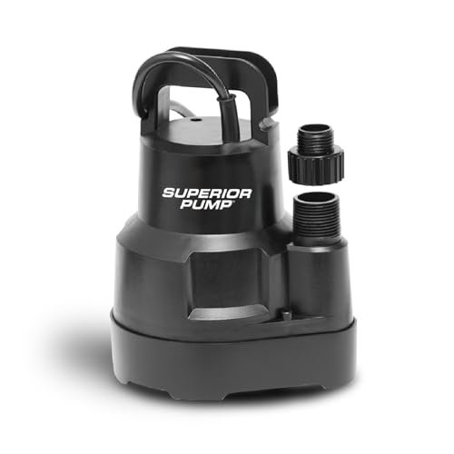

Method 3: Submersible Pump System
A submersible pump can vacuum without any pool plumbing connections, but it's the fussiest of the four methods: most consumer submersibles aren't really designed to pull debris through a long vacuum hose, and running one dry or against a clogged head will burn it out. It also pumps water out of the pool (to waste), so the level can drop fast—especially on a smaller pool. Treat it as a backup when the others aren't options, and watch both the water level and the intake screen.
  1. Select an appropriate submersible pump specifically designed and rated for continuous underwater operation in pools (minimum 1/3 HP recommended for pools)
  2. Connect a standard pool vacuum hose to the pump's intake
  3. Attach the vacuum head to the other end of the hose
  4. Lower the pump into the deep end of your pool
  5. Connect the pump's discharge hose to drain away from the pool area
  6. Plug in the pump (ensure GFCI protection) and verify suction at the vacuum head
  7. Begin vacuuming methodically, working from shallow to deep areas
  8. Monitor the discharge to ensure proper drainage away from the pool
  9. Check the pump's intake screen periodically and clean if clogged
